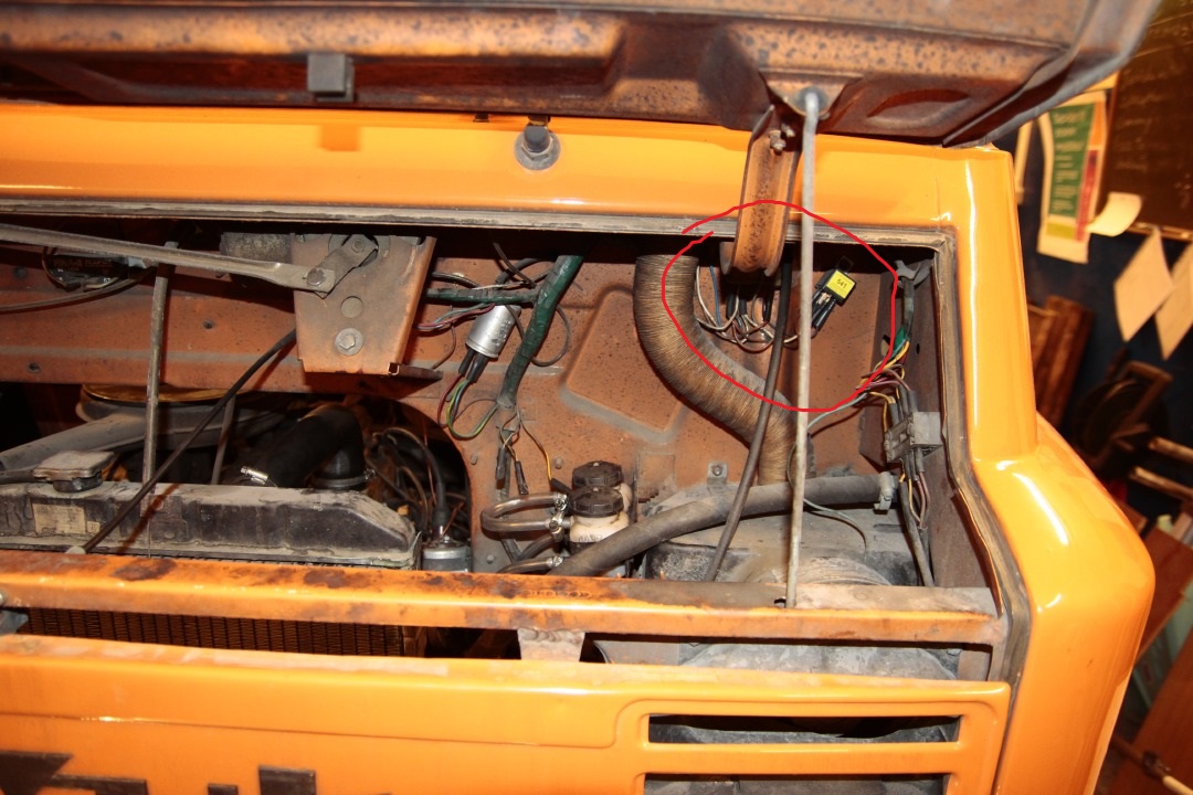

Hello everyone. Soon I will post introduction of my Zuk project in United Kingdom!
First I need help. I re-wire electronics due to poor installations previously.
Question: Where is " relay " for headlamps location on Zuk 1985 Straz?
It is not on bulkhead / firewall... I am worried there is no relay.. some wires melted by previous owner...
Please advise. Sorry for my English.
Zuk forever.
Andy
Post: 07 lutego 2017, 23:43
I believe in 1985 the circuits of front lamps should have relays. They should be installed under the front bonnet on the wall, quite near the hole of the electric bunch (relays for both, the "normal" and the stroner "road"). If there is none, or was removed - it's not good then. However - older Żuks, with a different main lamps switch was not equipped with relays.
But this year should have it.

Hi Marian,
Thanks for the reply, unfortunately I have no relay here.
I am surprised about the age of Zuk, it feels older, but log book document says 1985.
The wiring behind dashboard.. was like nothing I've ever seen before...
As you see nothing on back wall.. maybe time to fit relay.

Post: 08 lutego 2017, 22:03
yeah, relays should be in locaction like this on Marian's photo, but in 85' they rather been older type, bigger.
I have one Fire Engine Żuk 84' in my workshop, so I look tomorow what's under hood:)
about mess in electricity-cables are rather ok, but pins should be replaced; i prefer seal connectors under hood like this:
http://www.neonplus.pl/?596,gniazdo-szc ... krotne-kpl
be careful and dont trust colours of cables, they were often changed in production

Thanks! I will add new relay before LandRover lights are fitted. I converted so I can fit any "wipac" headlight in UK.

Today i looked under żuk 84' hood- there's no relay. maybe under dashboard they can be, but i can't check it;customer took żuk away.

Hi there,
there was no relay in my 1980 and 1984 Żuks. There are original relays in my 1986 and 1990 ones.

I thought it strange 2 x fuses, 2 x high / low beam lights. I think I re-wire new lights also.

Thanks for confirming my model have no relay!
